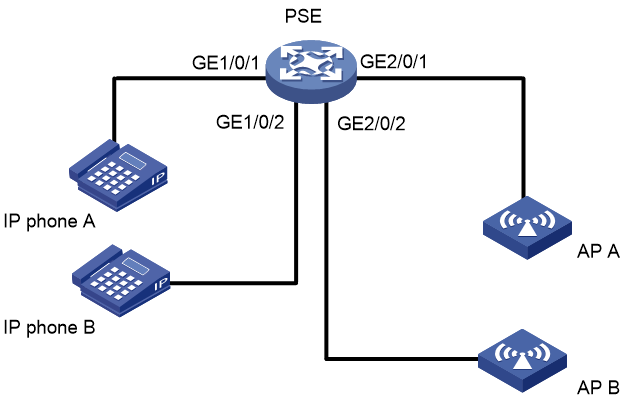

PoE system
As shown in Figure 1, a PoE system includes the following elements:
·     PoE power supply—A PoE power supply provides power for the entire PoE system.
·     PSE—A power sourcing equipment (PSE) supplies power to PDs. PSE devices are classified into single-PSE devices and multiple-PSE devices.
¡     A single-PSE device has only one PSE firmware.
¡     A multiple-PSE device has multiple PSEs. A multiple-PSE device uses PSE IDs to identify different PSEs. To view the mapping between the ID and slot number of a PSE, execute the display poe device command.
·     PI—A power interface (PI) is a PoE-capable Ethernet interface on a PSE.
·     PD—A powered device (PD) receives power from a PSE. PDs include IP telephones, APs, portable chargers, POS terminals, and Web cameras. You can also connect a PD to a redundant power source for reliability.
Figure 1 PoE system diagram

Example: Configuring PoE
As shown in Figure 2, the device has PSE 4 and PSE 7, in slot 1 and 2, respectively. Configure PoE to meet the following requirements:
·     PSE 4 has a maximum power of 400 watts.
·     The device supplies power to IP phones and APs.
·     The device supplies power preferentially to IP phone B when power overload occurs.
·     Power supplied to AP B does not exceed 9000 milliwatts.
Figure 2 Network diagram
# Enable the PI priority policy.
<PSE> system-view
[PSE] poe pd-policy priority
# Enable PoE for the PSE.
<PSE> system-view
[PSE] poe enable pse 10
[PSE] poe enable pse 16
# Set the maximum power of PSE 10 to 400 watts.
[PSE] poe pse 10 max-power 400
# Enable PoE on GigabitEthernet 1/0/1 and GigabitEthernet 2/0/1.
[PSE] interface gigabitethernet 1/0/1
[PSE-GigabitEthernet1/0/1] poe enable
[PSE-GigabitEthernet1/0/1] quit
[PSE] interface gigabitethernet 2/0/1
[PSE-GigabitEthernet2/0/1] poe enable
[PSE-GigabitEthernet2/0/1] quit
# Enable PoE on GigabitEthernet 1/0/2, and set its power priority to critical.
[PSE] interface gigabitethernet 1/0/2
[PSE-GigabitEthernet1/0/2] poe enable
[PSE-GigabitEthernet1/0/2] poe priority critical
[PSE-GigabitEthernet1/0/2] quit
# Enable PoE on GigabitEthernet 2/0/2, and set its maximum power to 9000 milliwatts.
[PSE] interface gigabitethernet 2/0/2
[PSE-GigabitEthernet2/0/2] poe enable
[PSE-GigabitEthernet2/0/2] poe max-power 9000
# Verify that the device is supplying power correctly to the IP phones and APs, and the IP phones and APs are operating correctly.
